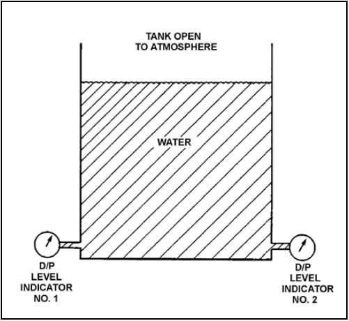

Refer to the drawing of a water storage tank with two differential pressure (D/P) level indicators (see figure below).
Indicator 1 was calibrated at 120°F and indicator 2 was calibrated at 180°F.
If tank water temperature is currently 150°F, then indicator…
A. 1 will read greater than indicator 2, and greater than actual level.
B. 1 will read greater than indicator 2, and less than actual level.
C. 2 will read greater than indicator 1, and greater than actual level.
D. 2 will read greater than indicator 1, and less than actual level.
Answer: C
