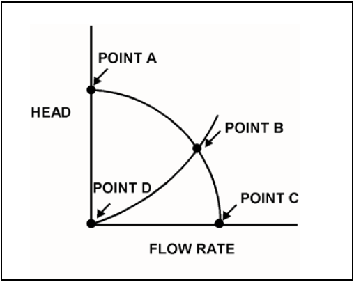

Refer to the drawing of centrifugal pump and system operating curves (see figure below).
Which point represents pump operation at shutoff head?
A. Point A
B. Point B
C. Point C
D. Point D
Answer: A
