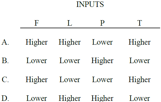

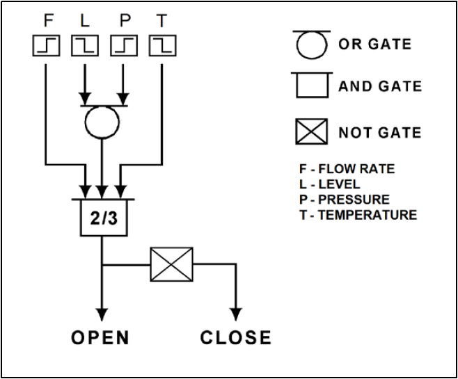

Refer to the logic diagram for a valve controller (see figure below).
Which one of the following combinations of flow rate (F), level (L), pressure (P), and temperature (T) inputs will result in the valve receiving a CLOSE signal?
(The options below indicate whether the parameters are higher or lower than the associated bistable setpoints.)
Answer: A
