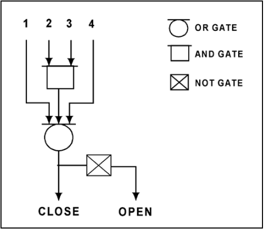

Refer to the valve controller logic diagram. Which one of the following combinations of inputs will result in the valve receiving an OPEN signal ___
Refer to the valve controller logic diagram (see figure below).
Valve Control Logic Diagram-21

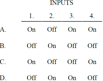

Which one of the following combinations of inputs will result in the valve receiving an OPEN signal?
Inputs -PG-21
Answer: B
