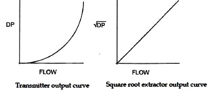

When a differential pressure cell is used to transmit a flow measurement the output of the transmitter is not linear. Therefore, in many flow measurement installation a square root extractor is fitted to the output of a differential pressure transmitter.
Relationship between differential pressure and flow
