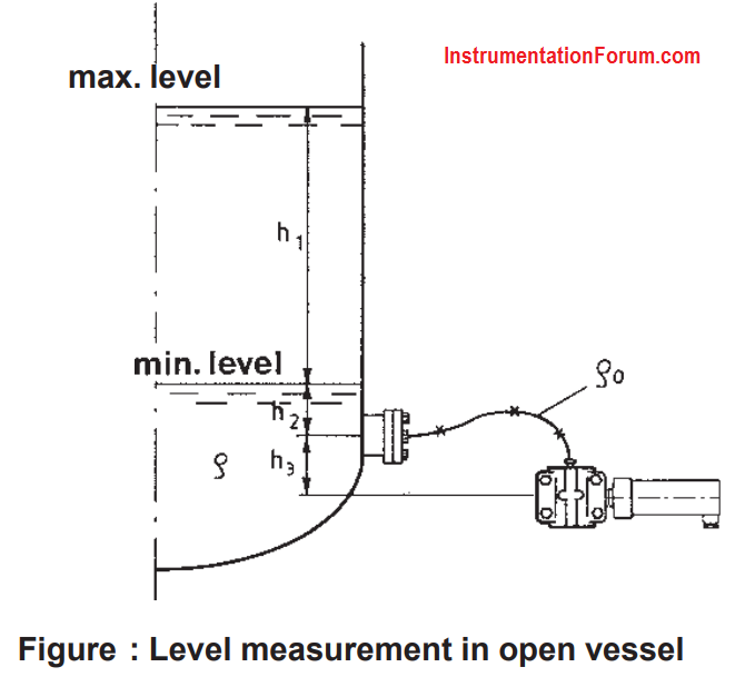

Level Measurement in Open Vessel
Example 1: Open vessel (Fig.)
Span p1 , is as follows:
P1 = h1 ρ g
= 3.50 m × 980 kg/m3 × 9.81 m/s2 = 33.6 kPa
Zero suppression p2 is as follows:
P2 = (h2ρ+ h3ρO) × g
= (1.00 m × 980 kg/m3 + 0.90 m × 960 kg/m3 × 9.81 m/s2
= 18. 1 kPa

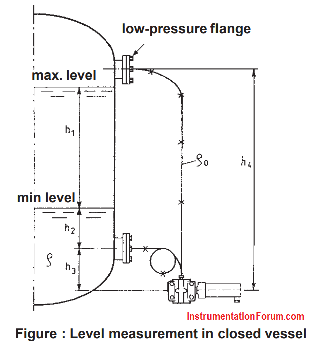

Level Measurement in Closed Vessel
Example 2: Closed vessel (Fig.)
Span p1, is as follows:
P1 = h1 ρ g
Zero elevation (suppression) p2 is as follows:
P2 = (h3-h4) ρ0g + h2ρg =
(0.90-6.00)m × 960 kg/m3 × 9.81 m/s2 + 1.00 m × 980 kg/m3 × 9.81 m/s2
P2 = -38.4 kPa (negative result = elevated-zero range)
h1= difference in height between maximum and minimum level (3.50 m)
h2 = height of minimum level from (+) - flange (1.00 m)
h3 = difference in height between (+)- flange and transmitter(0.90m)
h4 = difference in height between (-)-flange and transmitter(6.00 m)
ρ = density of measured fluid (980 kg/m3)
ρ0 = density of fill fluid (960 kg/m3)
g = acceleration of gravity (9.81 m/s2)
NOTE: If transmitter is higher than the (+)-flange, the difference h3 will have a negative value.
