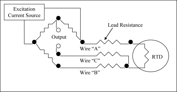

Why are RTDs sometimes called 2, 3 or 4 wire RTDs? And why would I want one RTD wire configuration instead of another?
A simple rule of thumb is that the more wires an RTD has the more accurate it is. The entire RTD assembly is not platinum. Among other issues, constructing an RTD in that manner would for most purposes be prohibitively expensive.
As a result, only the small RTD element itself is made of platinum. As a practical matter the resistance value of the RTD element would be useless without a means to communicate that resistance to an instrument. Accordingly, insulated copper wires typically connect the RTD element to the measuring instrument.
Like platinum, copper has a resistance value. Resistance along the copper lead wires can impact the resistance measurement determined by the instrument connected to the RTD.
Two wire RTDs do not have a practical means for accounting for the resistance associated with the copper lead wires which reduces the extent to which the resistance measured can be accurately correlated to the temperature of the RTD element.
As a result, two wire RTDs are least commonly specified and are generally used where only an approximate value for temperature is needed.
Three wire RTDs are the most common specification for industrial applications. Three wire RTDs normally use a Wheatstone bridge measurement circuit to compensate for the lead wire resistance as shown below.
In a 3 wire RTD configuration, Wires “A” & “B” should be close to the same length. These lengths are significant because the intention of the Wheatstone bridge is to make the impedances of wires A and B, each acting as an opposite leg of the bridge, cancel the other out, leaving Wire “C” to act as a sense lead carrying a very small (microamperage range) current.
4 Wire RTDs are even more accurate than their 3 wire RTD counterparts because they are able to completely compensate for the resistance of the wires without having to pay particular attention to the length of each of the wires. This can provide significantly increased accuracy at the relatively low cost of increased copper extension wire.

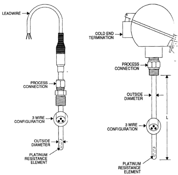

What are the common components of an RTD?
1. RTD platinum resistance element: This is the actual temperature sensing portion of the RTD. Elements range in length from 1/8" to 3". There are many options. The standard temperature coefficient is an alpha of .00385 and the standard resistance is 100 Ω at 0° C.
2. RTD Outside diameter: The most common outside diameter is ÂĽ" in the US or 6mm (.236") for non-US applications. However, outside diameters range from .063" to .500"
RTD Tubing Material: 316 Stainless steel is commonly used for assemblies up to 500° F. Above 500° F it is advisable to use Inconel 600.
3. RTD Process Connection: Process connection fittings include all standard fittings used with thermocouples (i.e. compression, welded, spring-loaded, etc.).
4. RTD Wire Configuration: RTDs are available in 2, 3 and 4 wire configuration. 3 wire configurations are the most common for industrial applications. Teflon and fiberglass are the standard wire insulation materials. Teflon is moisture resistant and can be used up to 400° F. Fiberglass can be used up to 1000° F.
5. RTD cold end termination: RTDs can terminate on the cold end with plugs, bare wires, terminal heads and any of the reference junctions common to thermocouples.
