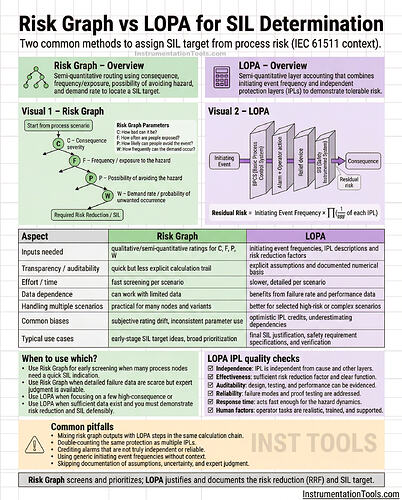

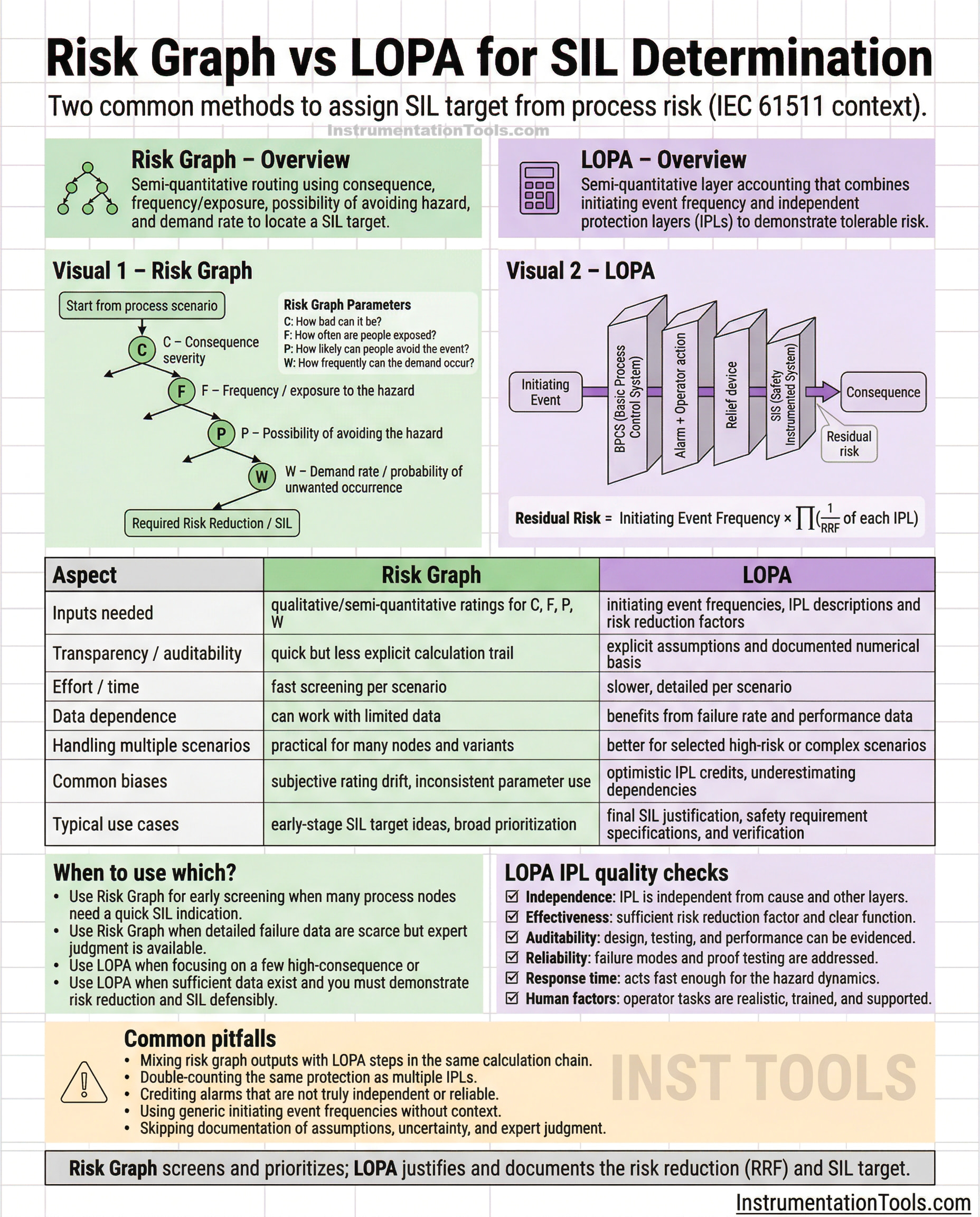

Risk graph vs LOPA for SIL determination
:shield: Risk Graph vs LOPA — SIL Determination Made Simple
When deciding SIL levels, engineers often ask:
:backhand_index_pointing_right: Risk Graph or LOPA… which one to use?
Here’s a clear comparison :backhand_index_pointing_down:
:gear: Risk Graph Method
:right_arrow: Qualitative approach
:right_arrow: Uses parameters like:
:small_blue_diamond: Severity (S)
:small_blue_diamond: Frequency (F)
:small_blue_diamond: Probability (P)
:small_blue_diamond: Avoidance (A)
:backhand_index_pointing_right: Based on answers, SIL is selected from a graph/chart
:rocket: Why Risk Graph is used
:high_voltage: Quick and simple
:high_voltage: Less data required
:high_voltage: Useful in early project stages
:warning: Depends heavily on engineering judgment
:gear: LOPA (Layers of Protection Analysis)
:right_arrow: Semi-quantitative method
:right_arrow: Uses numerical values for:
:small_blue_diamond: Event frequency
:small_blue_diamond: Protection layer effectiveness
:small_blue_diamond: Risk reduction
:backhand_index_pointing_right: Calculates required SIL more accurately
:rocket: Why LOPA is used
:high_voltage: More detailed and reliable
:high_voltage: Based on actual data
:high_voltage: Widely used in real projects
:brain: Key Differences
:small_blue_diamond: Risk Graph → Qualitative
:small_blue_diamond: LOPA → Semi-quantitative
:small_blue_diamond: Risk Graph → Faster
:small_blue_diamond: LOPA → More accurate
:small_blue_diamond: Risk Graph → Early design stage
:small_blue_diamond: LOPA → Detailed design stage
:factory: Practical approach
:backhand_index_pointing_right: Risk Graph → Initial SIL estimation
:backhand_index_pointing_right: LOPA → Final SIL confirmation
:bullseye: Key takeaway
:one: Use Risk Graph for quick screening
:two: Use LOPA for final decision
:three: Both aim to reduce risk to acceptable level
:backhand_index_pointing_right: Risk Graph = Quick judgment
:backhand_index_pointing_right: LOPA = Calculated decision
