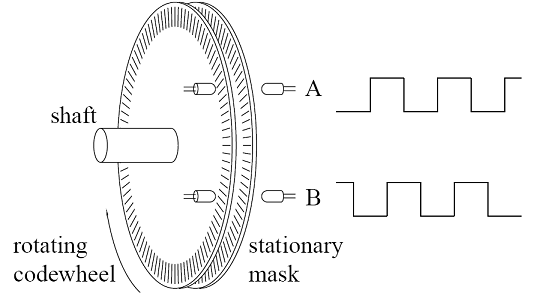

As radial lines in each track interrupt the beam between a photoemitter-detector pair, digital pulses are produced.
Below is a figure of an encoder with a spinning codewheel and a stationary mask. This stationary mask is usually not used.
