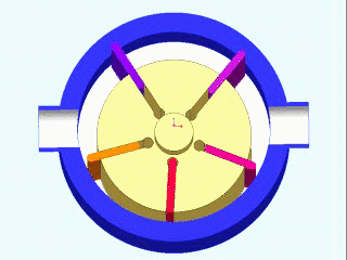

Types of rotary pumps include cam-and-piston, internal-gear, lobular, screw, and vane pumps. Gear pumps are found in oilfired home heating systems.
