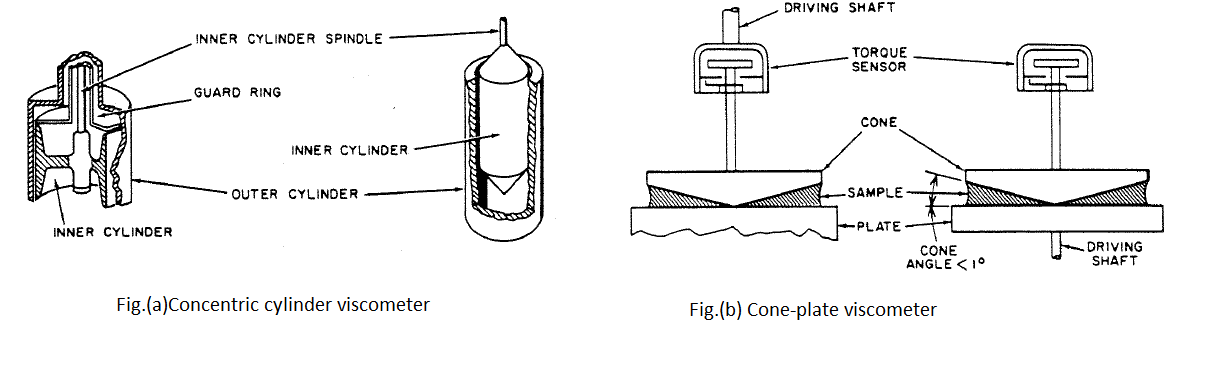

- They are amongst the most widely used meters.
- The principle used behind this method involves torque required to rotate cylinder is dependent on viscosity of fluid.
- They are classified as
1)Cup bob (concentric cylinder) type
2)Cone Plate type - Concentric cylinder assembly involves two cylinder one over other separated by liquid between them, one of them is kept static and other one rotates & generates torque.
- Cone & plate assembly uses narrow angled cone with flat plate, shear stress & shear rate at given angular velocity gives viscosity.
- Air gap due to bubbles might induce error.
