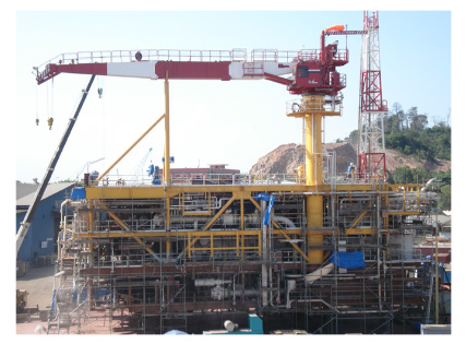

What are the required Safety Inspection’s Guide Line at Construction Site for Crane and mention the steps involved in checking.
