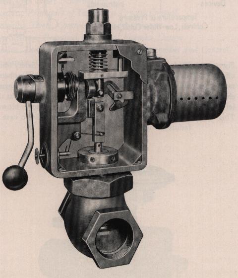

When this type of valve is tripped, the flow is quickly stopped and an indicator disc tells the operator that the electrical circuit has been opened by a failure somewhere in the system. When the system failure has been corrected so that the circuit is again closed, the valve can be opened by the action of the hand lever. If, however, the system failure has not been satisfactorily corrected, the circuit will remain open and moving the hand lever will not open the valve, because the valve stem remains disengaged from the handle.
Figure : A diagram of the internal components of a safety shutoff valve
In a solenoid-operated safety shutoff valve, a spring action closes the valve instantly when an electric current fails and the solenoid ceases to be energized. The solenoid circuit is generally arranged so that it is broken upon failure of any element of the system. This valve cannot be re-opened until the solenoid is again energized.
