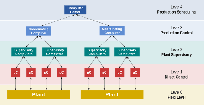

The accompanying diagram is a general model which shows functional manufacturing levels using computerised control.
Referring to the diagram,
Level 0 contains the field devices such as flow and temperature sensors, and final control elements, such as control valves.
Level 1 contains the industrialised input/output (I/O) modules, and their associated distributed electronic processors.
Level 2 contains the supervisory computers, which collate information from processor nodes on the system, and provide the operator control screens.
Level 3 is the production control level, which does not directly control the process, but is concerned with monitoring production and targets.
Level 4 is the production scheduling level.
Level 1 contains the programmable logic controllers (PLCs) or remote terminal units (RTUs).
Level 2 contains the SCADA software and computing platform. The SCADA software exists only at this supervisory level as control actions are performed automatically by RTUs or PLCs. SCADA control functions are usually restricted to basic overriding or supervisory level intervention.
For example, a PLC may control the flow of cooling water through part of an industrial process to a set point level, but the SCADA system software will allow operators to change the set points for the flow. The SCADA also enables alarm conditions, such as loss of flow or high temperature, to be displayed and recorded. A feedback control loop is directly controlled by the RTU or PLC, but the SCADA software monitors the overall performance of the loop.
Levels 3 and 4 are not strictly process control in the traditional sense, but are where production control and scheduling takes place.
