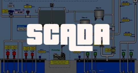

Mimic Screen Animation
As the name suggests, Mimic Screen is to imitate the physical look of the devices or equipment on the screen. However, it is meaningless if the mimic just imitate the physical object into the screen. So, the equipment will also reflect the status on the screen itself, and we call this process as animation.
The simplest animation is color changes, representing different status according to specific legend. For instance, Stop status as red, Run status as green. More lively animation would be rotation, or movement for equipment’s state indication. For example a rotating agitator, a level indication, a moving conveyor, etc.
Besides data and status reading, mimic screen also allows user to control the linked up equipment, so that starting or stopping of a system can be done through mouse click. The beauty of Mimic Screen is to allow operators to have the overview of the plant floor without needing them to enter the site to monitor the condition, as well as control the devices without any physical access.
