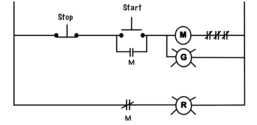

D. A drum-switch controller - If the circuit in the drawing was operating normally and an overload occurred, then
A. Both lights would come on
B. The green light would come on, and the red light would go out
C. Both lights would go out

Answers - D
- C
- D
- C
- A
- A
- False
- D
- True
- B
- C
- C
- D
- B
- B
- A
- C
- 3 and 4
- True
- Closed
- True
- False
- A
