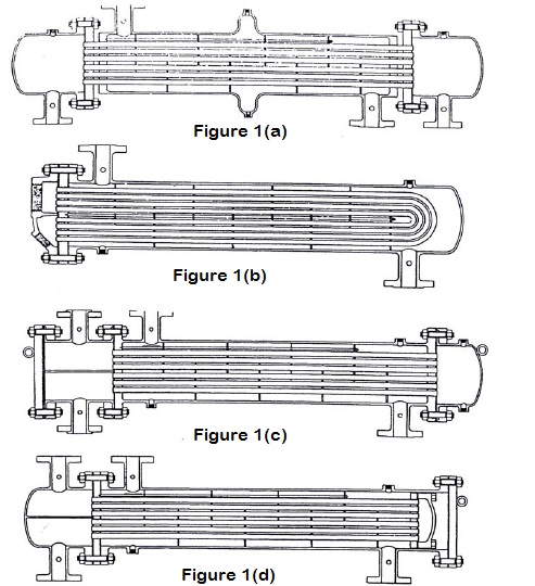

Parts of shell and tube heat exchanger as following below:
Figure 1: Mechanical Arrangement of Tube and Shell Heat Exchanger

Figure 1 shows mechanical arrangement of shell and tube heat exchanger. Figure 1(a) shows arrangement of one shell and tube single-pass, while Figure 1(b) to Figure 1(d) shows arrangement of one shell and two tube-passes. Figure 1(b) is arrangement for U-tube type. Figure 1© for fixed tubesheet and Figure 1(d) for floating tubesheet.
