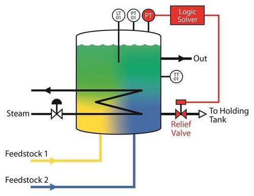

Validation of a SIF is only one step in the larger SLC, but it is critical. Figure 1 shows a hypothetical example of a typical SIF applied to a continuous process. In this example, two liquid feedstocks are pumped into a reactor, and then heated and agitated so they form a new compound that flows out of the reactor near the top. Temperature, pressure, and level are measured with TT01, PT01, and LT01 respectively.
The hazard analysis warns of a possible overpressure incident if the output flow is obstructed, thus the designers specify a SIF capable of creating a second outlet to allow some of the contents to pass to a holding tank. This may not be the only SIF connected with the reactor. There could be another SIF designed to shut off the steam to the heater if the temperature becomes too high, or feedstock inputs might be cut off if the level in the reactor gets too high.
Under normal operating conditions, the basic process control system (BPCS) keeps these parameters on an even keel. For this example, it probably would do a good job more than 99.99% of the time. Unfortunately, in the real world, things can and do go wrong. The steam control valve might stick or the pump extracting the product from the reactor may fail. In those cases, the BPCS can’t always address the situation, and the SIF must step in and do its job.

When these parameters are set, the equipment can be installed and is ready for validation. This is the moment of truth when everything must work, despite every attempt by those doing the testing to make it fail. Given its critical nature, validation must be a careful and well-thought-out process in compliance with relevant standards, and it must be fully documented. Performing the series of tests required might be a complex process and involve a variety of other plant personnel, as exemplified by these typical steps:
