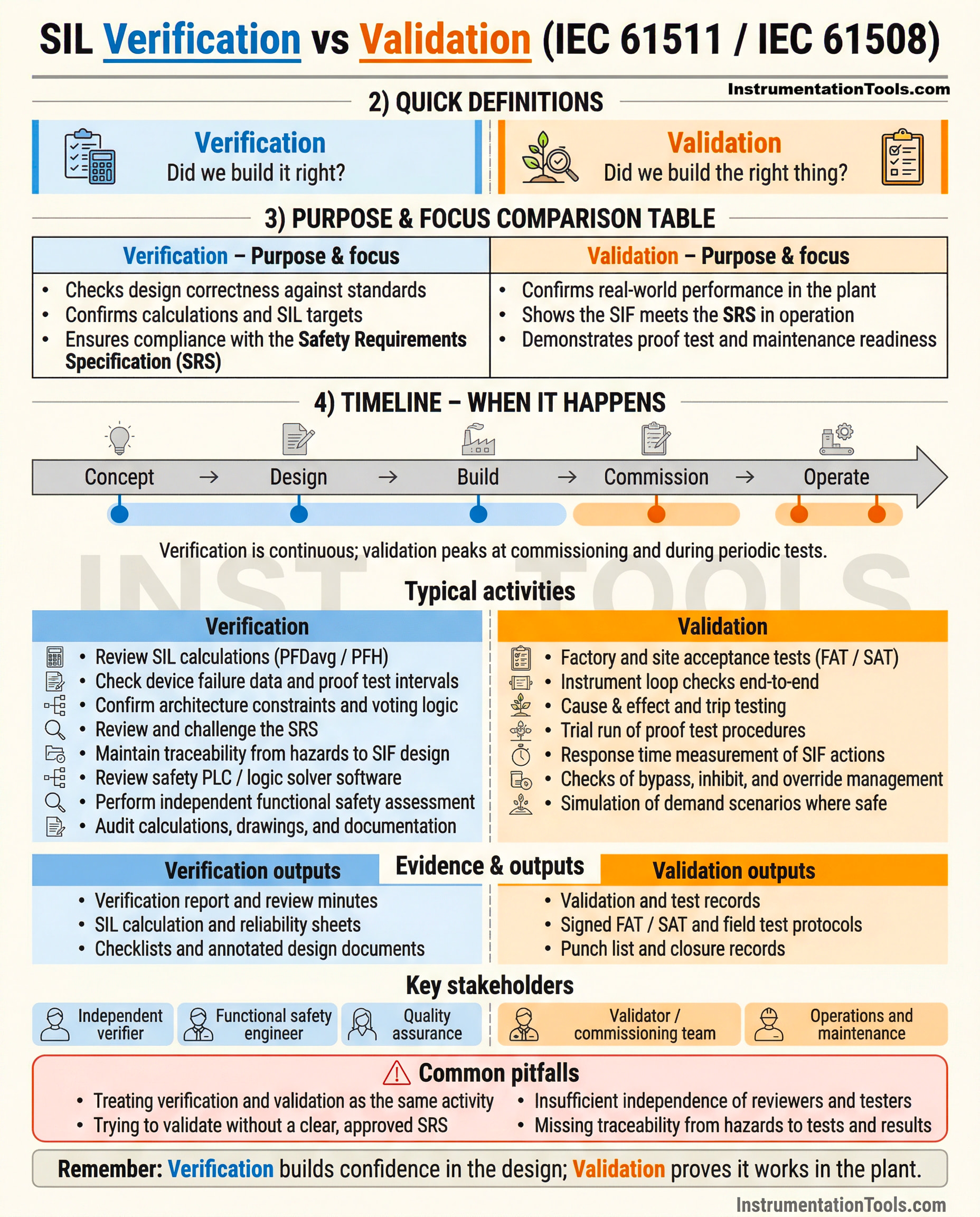

:shield: SIL Verification vs Validation — Don’t Mix Them Up
In functional safety, these two steps look similar…
But they answer two completely different questions :backhand_index_pointing_down:
:gear: SIL Verification
:right_arrow: “Did we design it correctly?”
:small_blue_diamond: Mathematical / analytical check
:small_blue_diamond: Confirms SIL target is achieved
:small_blue_diamond: Uses PFD, failure rates, calculations
:small_blue_diamond: Done during design phase
:backhand_index_pointing_right: Focus = Design correctness
:gear: SIL Validation
:right_arrow: “Does it actually work in real conditions?”
:small_blue_diamond: Practical testing of the system
:small_blue_diamond: Confirms SIF performs as intended
:small_blue_diamond: Includes loop checks, functional tests
:small_blue_diamond: Done before commissioning / startup
:backhand_index_pointing_right: Focus = Real-world performance
:brain: Simple comparison
:small_blue_diamond: Verification → Theory :bar_chart:
:small_blue_diamond: Validation → Practice :hammer_and_wrench:
:small_blue_diamond: Verification → Calculations
:small_blue_diamond: Validation → Testing
:factory: Example
:backhand_index_pointing_right: SIL 2 required:
:small_blue_diamond: Verification → Check if design meets SIL 2 mathematically
:small_blue_diamond: Validation → Test if system actually trips correctly
:bullseye: Key takeaway
:one: Verification ensures design meets target
:two: Validation ensures system works in field
:three: Both are mandatory for safety compliance
:warning: Common mistake
:cross_mark: Doing only calculations
:cross_mark: Skipping real testing
:backhand_index_pointing_right: Verification = “Right design?”
:backhand_index_pointing_right: Validation = “Works correctly?”
