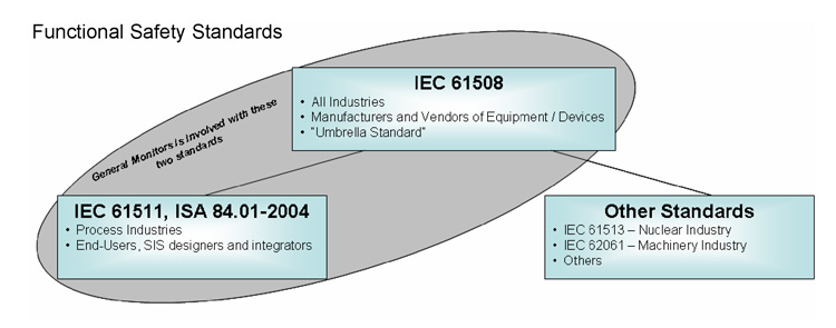

Functional Safety Standards
The ANSI/ISA-84.00.01-1996 was the first standard developed by the ISA SP84 committee to address the need to increase safety by systematically reducing process risk. The standards are updated approximately every 5 years and the most recent version was released in 2004. The new version adopts the IEC 61511 standard and adds the original 1996 version of ANSI/ISA 84 as a “grandfather clause”.
IEC 61508 is an umbrella standard released by the International Electrotechnical Committee in 1998 that is based on ANSI/ISA 84 and applies to all industries. The IEC 61508 standard is viewed as the document that vendors follow to receive certification for SIL suitability ratings for products and system components.
IEC 61511 was released in 2003 and was developed specifically to address functional safety in the process industry. This document is used by end-users to successfully implement system safety throughout the entire life-cycle of a system.
