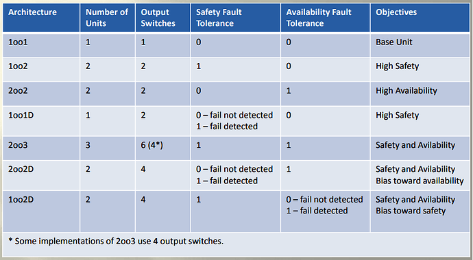

The most common voting arrangements used in industry are as follows:
- One-out-of-one (1oo1) – a.k.a., simplex
- One-out-of-two (1oo2)
- Two-out-of-two (2oo2)
- Two-out-of-three (2oo3)
There are two parts to the voting arrangement description. The first number is the number of devices that must “vote” to cause a trip for the trip to occur. The second number is the total number of devices. Thus, in a 2oo2 voting arrangement, 2 devices must vote to trip, out of a total of two device for the shutdown action to be taken.

Knowing these two failure modes is critical because the use of redundancy can only affect one of these modes depending on the voting arrangement.
Now that failure modes of been described, let’s go through each of the voting arrangements and describe them physically and compare their probability of failing dangerously as well as their spurious trips.
