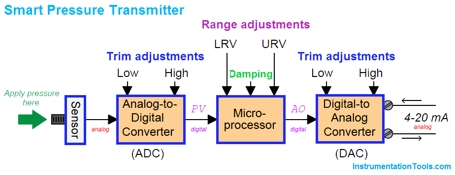

Components of the smart transmitter are illustrated in the lower figure. The transmitter is built into a housing, about the size of a softball, as seen in figure.
The controller takes the output signal from the transmitter and sends it back to the final control element. The communicator is shown on the right. The communicator is a hand-held interface device that allows digital “instructions” to be delivered to the smart transmitter.
Testing, configuring, and supplying or acquiring data are all accomplished through the communicator. The communicator has a display that lets the technician see the input or output information. The communicator can be connected directly to the smart transmitter, or in parallel anywhere on the loop.

Smart transmitters can be configured to meet the demands of the process in which they are used. For example, the same transmitter can be set up to read almost any range or type of thermocouple, RTD, or thermistor; reducing the need for a large number of specific replacement devices.
RE-RANGING
The range that the smart transmitter functions under can be easily changed from a remote location, for example, by the technician in a control room. The technician or the operator has access to any smart device in the loop, and does not even have to be at the transmitter to perform the change. The operator does need to use a communicator, however.
A communicator allows the operator to interface with the smart transmitter. The communicator could be a PC, a programmable logic controller (PLC), or a hand-held device. The type of communicator depends on the manufacturer.
Re-ranging is simple with the smart transmitter; using a communicator, the operator can change from a 100 ohm RTD to a type-J thermocouple just by reprogramming the transmitter. The transmitter responds immediately and changes from measuring resistance to measuring millivoltage.
A smart transmitter will accept a wide range of inputs; for instance, with pressure units, the operator can determine ahead of time whether to use inches of water, inches of mercury, psi, bars, millibars, pascals, or kilopascals.

Smart transmitters can also perform signal conditioning, scanning the average signal and eliminating any noise spikes. Signals can be delayed (dampened) so that the response does not fluctuate. This is especially useful with a rapidly changing process.
SELF-DIAGNOSIS
Finally, a smart transmitter can diagnose itself and report on any problems in the process. For example, it can report on a circuit board that is not working properly.
