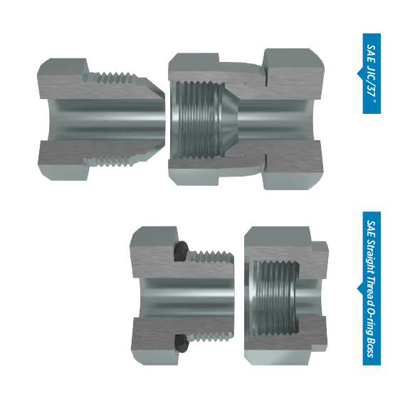

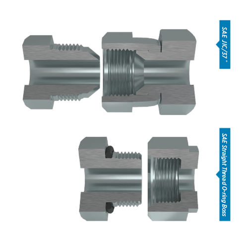

SAE J1926 Straight Thread O-Ring Boss (ORB) is recommended by the National Fire Protection Association (N.F.P.A.) for leak prevention in medium and high pressure hydraulic systems.
The male connection is a straight thread with an O-ring. The female port has a straight thread and a machined surface to provide a smooth, flat surface (minimum spotface), along with a chamfer where the O-ring seats. It seals when the O-ring is compressed into the chamfer when mating the male connection. This is also considered a mechanical connection.
SAE J514 JIC/37° Hydraulic connections are common in most fluid power systems. Both male and female components have 37° seats. The seal is made by establishing contact between the male flared and female coned seat. This is also considered a mechanical connection.
