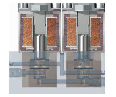

ROTEX is in a position to offer solutions for all of the above conditions using a Redundancy in Operator type principle which essentially combines independent Valve operating components arranged in redundant configurations. This concept is most superior to the Redundancy in Solenoid since it makes the complete valve component redundant to each other reducing the probability of failure of these valves. The system, essentially a single block solution, eliminates all interconnecting point leakage thereby increasing reliability and ensuring trouble free operation.
Especially for pilot operated solenoid valves, ROTEX offers a solution using Redundant operators in application requiring high availability of equipment to avoid spurious tripping. These are classified as Valves with Redundant Operators. ROTEX can also offer the Redundant Solenoid valves with In build Non Contact type switches to test the system availability for shutdown.
