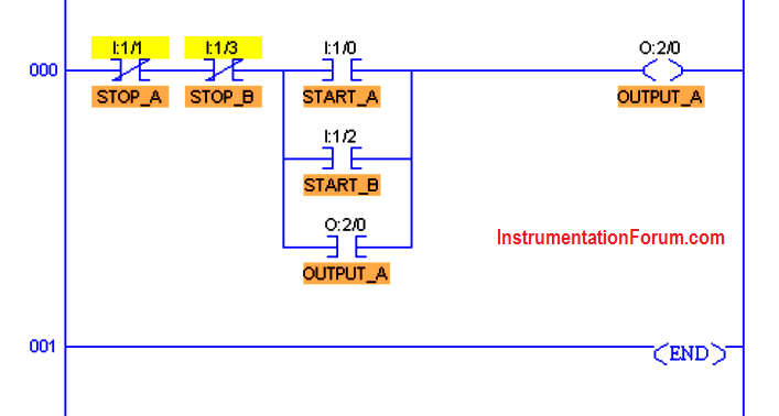

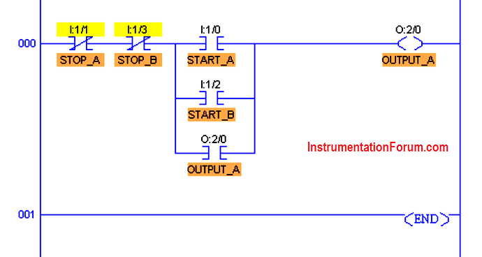

In practice, several start and/or several stop buttons can be used in a process.
Start buttons (with XIC instructions) can be used.
In series, if it is required that ALL be pressed before a process started.
In parallel, if pressing the ANY start button is to start a process.
Stop buttons (with XIO instructions) are normally used in series if pressing ANY stop button is to stop a process.
