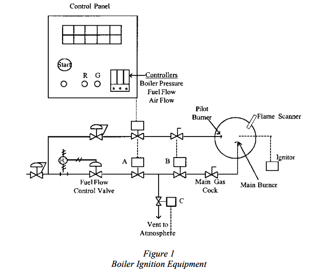

Small boilers often have completely automatic ignition systems. Some older, or specialized boilers, may have completely manual systems. Most boilers have a combined system, where some steps, such as 1 and 2 above, are done automatically, and the remaining steps require the operator to perform specific tasks within a set time period. As an example of a typical ignition procedure we will look at this type of system in the following discussion.
Fig. 1 shows the essential equipment components of an ignition system. Not all boilers will have equipment identical to this, but it is fairly typical of most systems apart from minor differences. To keep things simple we have chosen to describe a gas fired boiler. Pilot gas is supplied to the pilot burner through a pressure control valve and solenoid valve. Gas for the main burner is supplied through a pressure control valve, a flow control valve, the electrically operated automatic shut-off valves, and finally the main gas cock. The automatic shut-off valves are arranged in a “double block and bleed” system that ensures no gas can enter the furnace when the boiler is shut down. When shut down, valves A and B are both closed and vent C is open. When the boiler is operating, A and B are both open and C is closed. These valves are designed so that A and B will close and C will open, all automatically, in the event of a boiler shutdown. During start-up, C will close automatically, but A and B need to be manually actuated (latched) to open.
Fig. 1 also shows an outline of the local control panel for the boiler. This displays the alarms, fan switch, ignition switch, ignition status indicators (red and green lights), and the steam pressure, fuel flow, air flow and water level controls. To avoid clutter, all the normal indicators and recorders are not shown.
Before the ignition sequence can begin, all the boiler shutdown switches must be in their “permissive” states. For example, the water level must be within acceptable limits, and the fuel pressure must be within its acceptable limits. We will assume that all the required operating conditions have been satisfied.
We will also assume that all valves are in their proper start-up positions. In particular, the gas cock on the main gas line must be closed, and there is usually a position switch to check that this is the case. If this valve is not closed the ignition sequence will not be permitted to proceed. If the boiler has a superheater, it is common to open the superheater vent at this time, so that it does not overheat due to lack of steam flow.
Before starting the fan, the operator must place the steam pressure (also known as the Boiler Master), fuel flow and air flow controllers in manual mode, and set their outputs to the required ignition positions. The ignition sequence is then initiated by closing the fan switch. The programmer will automatically put the boiler into a pre-purge mode, with the required amount of air flow, for a specified time period. The minimum air flow setting on the air flow controller will be temporarily overridden during the purge period. Following the purge, a light on the panel will indicate “Purge Complete”, and the air flow dampers will return to the position assigned by the air flow controller.
The operator can now push the pilot igniter push button. This button must be held until the flame scanner senses a stable pilot burner flame. Initially, a red light goes on to indicate that the igniter is in operation, and that pilot gas is flowing to the burner. When pilot ignition occurs, the adjacent green light will go on. The operator may now release the igniter push button, since a stable pilot flame has been sensed.
The operator must now act efficiently to complete the ignition procedure, since the programmer will only allow for a specific time period to obtain main burner ignition. The next step is to open valves A and B by manually resetting them, usually this means repositioning a latching lever. Vent valve C will close automatically. Finally the operator must manually open the main gas cock next to the boiler. Gas will now flow to the main burner, and it will ignite from the pilot flame. If these steps are done in time, the ignition sequence is complete, and the firing rate can be increased to bring the boiler up to operating conditions.

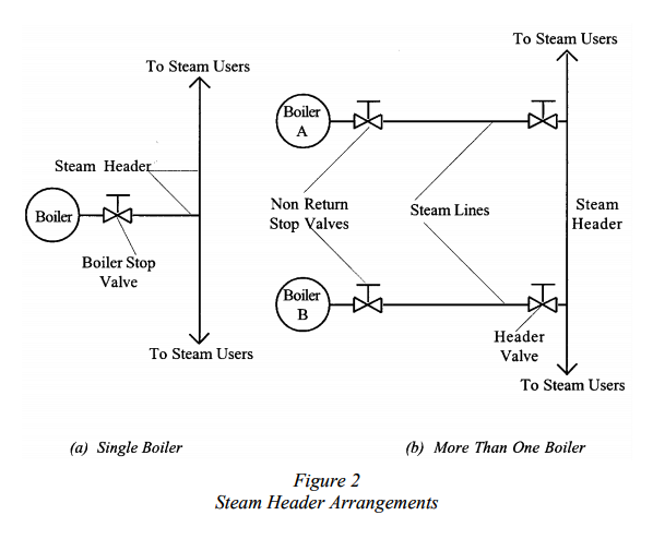

Steam headers conduct steam from the boiler to other equipment in the plant. They must be properly warmed up to avoid thermal stress, and to remove condensate as it forms. If this is not done, severe water hammer will result during the overall plant start-up. In some cases sufficient piping damage has occurred to cause loss of life. To see how the process of warming up and drying out steam headers is accomplished, we need to first take a quick look at how they are arranged in a plant.
Header arrangements are different depending on whether only one, or more than one, boiler produces into the header. Fig. 2 shows the two basic arrangements.
In Fig. 2(a) a single boiler produces steam into the header. The block valve at the outlet of the boiler is called the boiler stop valve, and is usually of the standard gate valve design. The piping downstream of the valve is referred to as the steam header (or steam main), and it supplies all the plant equipment taking steam at that pressure. In Fig 2(b) two boilers, A and B, are producing into the same steam header. Each boiler is equipped with a non-return type valve (described in the module “Introduction to Valves”), and a header valve. The section of line between the two valves is referred to as the boiler steam line, to distinguish it from the steam header.
In addition to these arrangements, plants can have several different steam headers, identified by the pressures at which they operate. Thus, for example, a plant may have a 10,000 kPa steam header, a 2000 kPa steam header, and a 350 kPa steam header. Alternatively, these may be referred to as the high, intermediate, and low pressure steam headers. Each of these headers may have its own boilers and steam users. It is common that these headers are connected in sequence; that is, the high pressure header “lets down” to the intermediate pressure header, which, in turn, lets down to the low pressure header.
With these arrangements in mind, let’s return to the discussion of how to warm up and dry out the piping during start-up. In a single boiler plant the easiest way to do this is to open up the boiler stop valve and header drains as soon as ignition has been obtained. As the boiler begins to produce steam, and slowly pressurizes, the header will be warmed from the steam. Condensate, which forms as the steam meets the cold piping, will be removed quickly from the header by the drains. By the time the boiler is up to its normal operating pressure the headers should be warm and dry. Alternatively, it is possible to leave the header isolated until the boiler reaches its operating pressure. At this point the stop valve is slowly opened and the header warmed up. As before, it is very important that the header drain valves are opened during this procedure.
In a plant with more than one boiler the procedure is somewhat different. There are two possible situations that require different procedures:
All the boilers have been shut down. The boiler we are starting up is the first to go on line . All steam headers are cold.
There are other boilers in the plant which are already on line. The main steam headers are already warmed up and pressurized.
The first case is treated exactly like the warm up procedure for a single boiler plant. The headers are opened up following ignition and warm up as the boiler is pressurized. In the second case the main steam headers are already in service but we still need to warm up the boiler steam line. Even though this is a relatively short length of piping compared to the overall steam header system, nevertheless, it is extremely hazardous to put this line into full service without warming it up and drying it out.

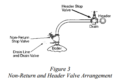

The procedure for opening up a boiler into a pressurized steam header is referred to as “cutting” the boiler into the header, and is described in Section VII of the ASME code. Fig.3 shows the related equipment.
To start the warm up, open the drain on the non-return valve. It is important to know that this drain is actually connected internally to the downstream side of the valve plug. Next, open the header valve a slight amount, allowing steam to flow from the steam header into the boiler steam line and out the drain. The boiler steam line will thus be warmed up with steam flowing back from the steam header. Any condensate present will be forced out the drain valve. The header valve can be slowly opened wide when the pressure has equalized between the steam header and the boiler steam line.
During this time the boiler has been slowly pressurizing. When boiler pressure is still a few kPa below the header pressure, the non-return valve spindle is backed off (that is, turned in the open direction) to about the one quarter open position. Note that, due to the check valve nature of this valve, it doesn’t actually open at this time, it will only begin to open when the boiler pressure exceeds the header pressure. By backing off the valve handle we are simply giving the valve some room to open when the pressure is high enough. As boiler pressure continues to rise, and finally exceeds header pressure, the non-return valve will begin to open until it reaches the one quarter limit that we set it at. We can now slowly open the valve the remainder of its travel, and close the drain. The boiler is now fully on line.
