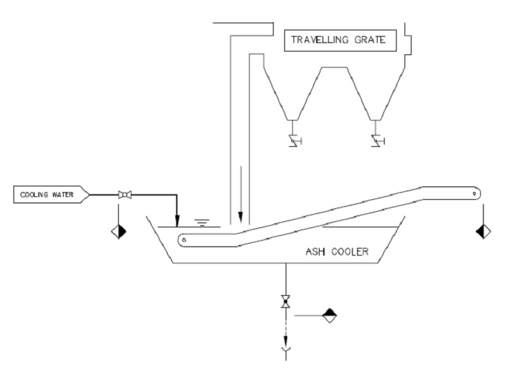

Bottom ash from the travelling grate is discharged through the ash chute hoppers installed at the end side of travelling grate as shown in Figure 1. The manual sliding damper is installed at each bottom of the air plenum hoppers. The air plenum damper should be opened minimum once per day to exhaust the riddling ash. And opening interval should be adjusted according to the condition of the quantity of riddling ash. Before open the damper, wheelbarrow should be prepared under the damper.
Figure 1: Traveling Grate Ash Handling Equipment
