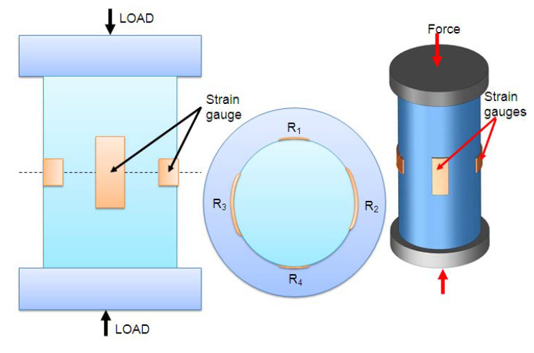

Figure shows a strain gauge load cell. It comprises of cylindrical tube to which strain gauges are attached. A load applied on the top collar of the cylinder compress the strain gauge element which changes its electrical resistance.
Generally strain gauges are used to measure forces up to 10 MN. The non-linearity and repeatability errors of this transducer are ±0.03% and ±0.02% respectively.
