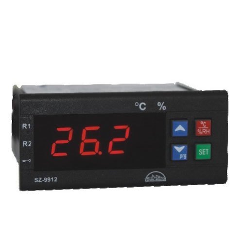

Main Feature:
• Indication for high / low temperature & Humidity. .
• Relay Out put for maintaining temperature & Humidity.
Input & Output:
• Relay output : 8(3)A for Temperature
• Relay output : 8(3)A for RH.
• Temp. Sensor Input : 1 PT-100
• RH Sensor (SZ - HS-100).
Application :
For humidification & dehumidification systems.
General Specification
• Humidity Range : 0% to 100%. Temperature range 0°C to +99.9°C.
• 230VAC Standard. Other models with 12VDC, 24VDC, 110VAC on request.
• Panel cutout : 29 X 71 mm Screw terminals : Admit 1X 2.5 mm² wire.
