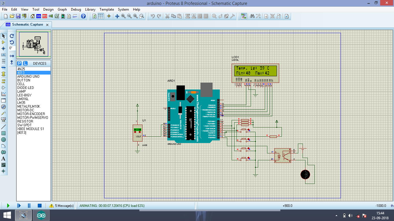

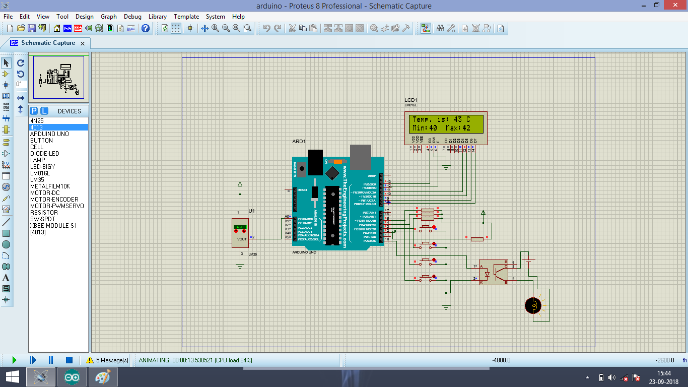

The picture basically describes an ON-OFF controller. Here bulb is taken as an example of machine, when machine temperature is above high set-point the optocoupler trips Machine from main line & when machine temperature is below lower set-point the optocoupler connects Machine from main line. Hence selecting the dead band is taken into concern considering accuracy of the sensor.
