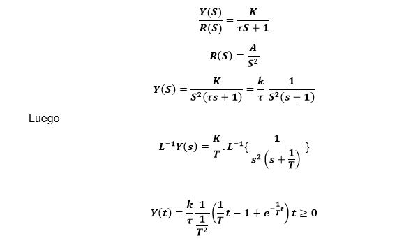

The response to a unit ramp is as follows:
If A = 1 before a unit ramp system, the behavior of the system is as follows:
If A = 1
So;
UNIT RAMP INPUT
if the amplitude of the input is changed

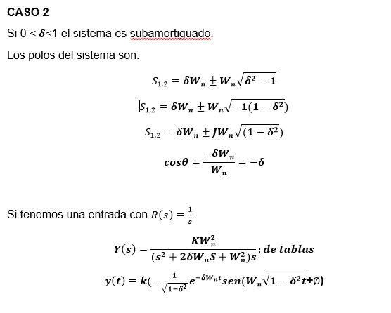

A second order system has the following equation as a transfer function:
Where;
The steady state gain corresponds to the constant value that the system takes for a very large time

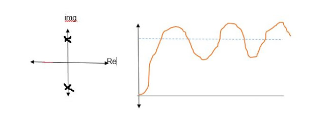

In addition, the response of the system depends on the roots of the denominator (system poles) for a second order plant, the poles are expressed as:
The poles and the output of the system are represented as follows

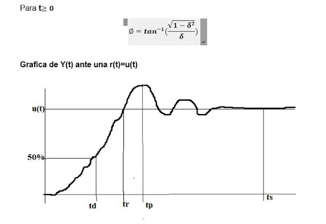

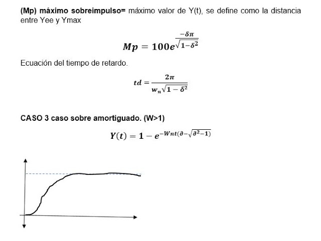

(td) delay time = time it takes for the first time to reach 50% of yee
(TR) growth time = is the time elapsed until the output changes from 0 to 100% of yee ie: yee = k
(tp) peak time = time in which ymax reaches its maximum value
ts) establishment time = Time elapsed until the output reaches an approximate range of 2% or 5% of yee
For a criterion of 2%
