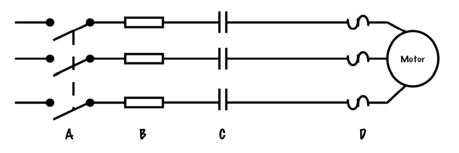

Using the above diagram, answer questions 1 to 5:
- Which letter identifies the component that normally provides overcurrent protection for the
motor branch circuit? - Which letter identifies the component that normally provides overload protection for the
motor branch circuit? - When energized by the control circuit, which letter identifies the component that provides
normal starting and stopping actions? - Between which two letters is the control circuit power normally taken from?
- Which letter(s) identify devices that must be horsepower rated?

Answers - B
- D
- C
- B and C
- A and C
