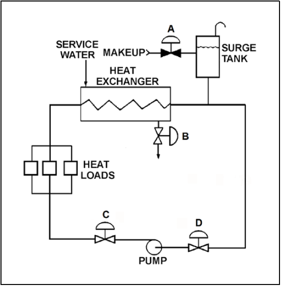

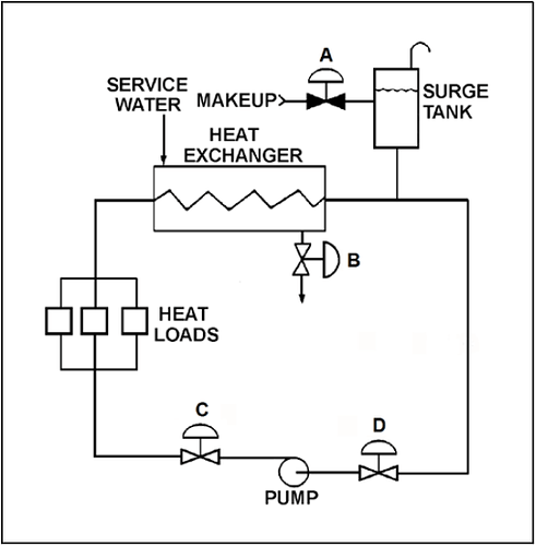

The available net positive suction head for the centrifugal pump will be increased by ___
Refer to the drawing of a cooling water system (see figure below).
The available net positive suction head for the centrifugal pump will be increased by…
A. opening surge tank makeup valve A to raise tank level.
B. throttling heat exchanger service water valve B more closed.
C. throttling pump discharge valve C more open.
D. throttling pump suction valve D more closed.
Answer: A
