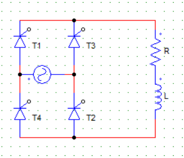

The below shown rectifier configuration has continues load current, find the expression for the average value of output voltage when the supply Vs = Vm sinωt is connected.
A. (Vm/π)cosα
B. (2Vm/π)cosα
C. (Vm/π) (1+cosα)
D. (2Vm/π) (1+cosα)
Answer: B
