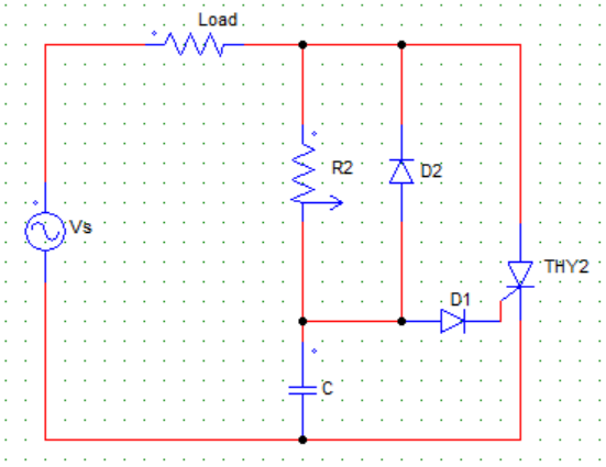

The figure shown below is that of an RC firing circuit.
99.RC Firing Circuit
In case of negative cycle at Vs, the capacitor C
A. charges through D2 with lower plate negative
B. charges through D1 with lower plate negative
C. charges through D2 with lower plate positive
D. charges through D1 with lower plate positive
Answer: C
