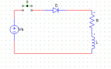

The initial current through the inductor is ___
In the circuit show below,
The initial current through the inductor is zero.
When the switch (shown in green) is closed, then the current through the inductor
Diode
A. decreases from Vs/R to 0
B. increases from zero to Vs/R
C. decreases from Vs/L to 0
D. increases from zero to Vs/L
Answer: B
