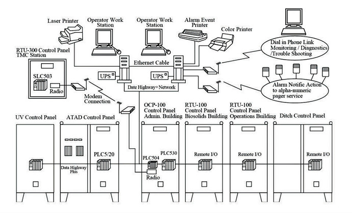

SCADA is an acronym for Supervisory Control and Data Acquisition. This presents the data as a viewable and controllable system on the screen of a computer.
The data thus collected can be stored and analysed for optimization of the process and for better real time process control.
It assists plant-operating personnel by monitoring and announcing abnormal conditions and failure of equipment.
It allows the operators to perform calculations based on the sensor inputs. Daily, weekly, monthly reports can be prepared using the stored data.
It also allows the operator to know the state of a process by an alarm associated with it.
A typical SCADA is shown in Figure.
SCADA System
Source: Kruger
Figure: Typical SCADA communication overview
