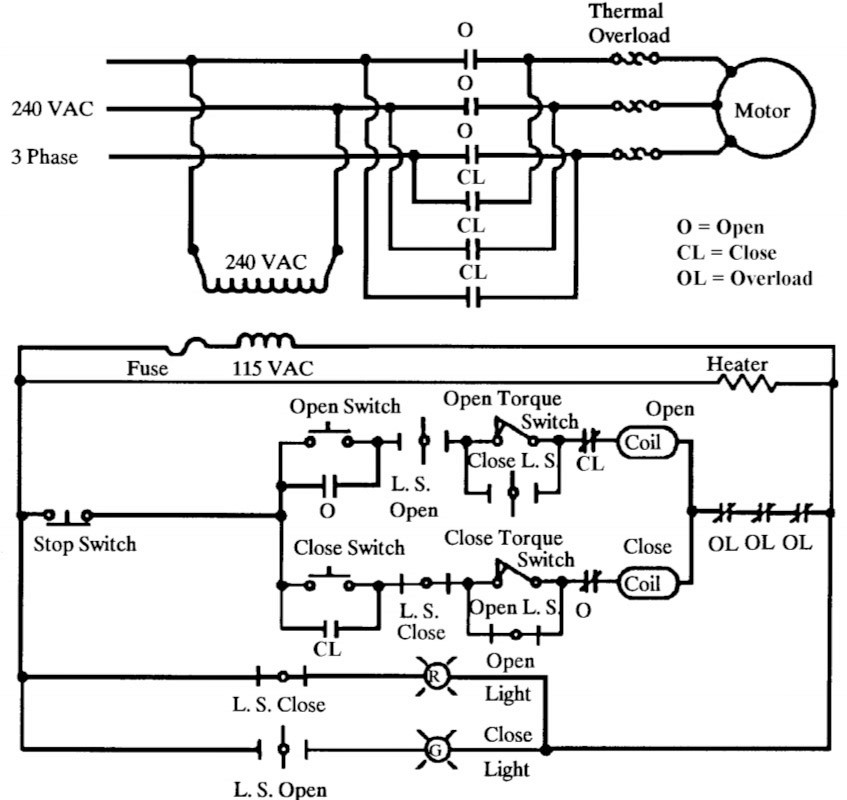

In the circuit, control power is transformed off incoming motor leads. The stop switch is normally closed
allowing a current flow path to exist up to the open and closed switches. The circuit as shown is deenergized with the valve in the full open position.
When the close direction switch (close switch) is closed, the closing coil of the Reversing Starter is energized. This will close the main line (motor leads) “CL” contacts to start the motor in the close direction, close the “CL” contact around the close switch (seal-in contact) and open the “CL” contact (electrical interlock contact) in series with the open coil.
The actuator will continue to position the valve in the close direction until the torque and/or limit switch detect binding or full stem travel, the respective contact will then open deenergizing the close coil which results in the main line contacts opening, the seal-in contact opening and the electrical interlock contact shutting.
The actuator can then be operated in the open direction in the same manner as described above. In the mid-position, the actuator can be operated in either direction.

Reversing starters have two separate functions: 1) to interchange power leads which change the direction of rotation, and 2) to provide mechanical and electrical safety interlocks that prevent the contacts for both directions being closed at the same time which would cause a direct short between phases.
The operation of the reversing starter is based on using a small control current to control the larger motor current through electromagnetic switching. The coils shown in Figureoperate the main contacts of the starter when an open or close pushbutton is pushed. In addition, the seal-in contacts and contacts labeled “CL” and “O” are operated by the same coils in the reversing starter.

The stop pushbutton(s) are always functional and are wired in series in the control circuit so that an operation by any one of them will open the circuit, which causes starter drop out and halts actuator operation.
They are a normally closed momentary open contact which de-energizes part of the circuit when pushed. Stop pushbuttons are usually located at each of the operating stations and locally at the actuator.
Open and Close Pushbuttons.
The function of the open and close pushbuttons is to initiate operation of the control circuit, which will result in energizing the actuator motor.
In typical applications,there are two sets installed - one at the valve (local) and one in the control room (remote). In some systems, only one set of open and close pushbuttons is energized at a time. See REMOTE/LOCAL switch.
Seal-in Contacts (Contactor Auxiliary Contacts)
The function of seal-in contacts is to allow the person operating the actuator to release the open and close pushbuttons without having the actuator stop. This allows electric controls to stop the operation automatically at a pre-set condition without operator intervention.
As an example, once energized, the actuator can be stopped by either the torque switch or limit switch depending on set-up of the valve-actuator. The seal-in contacts are labeled “O” and “CL” in Figure and are in parallel with either the open or closed switch.

Electrical Interlock Contacts
The electrical interlock contacts, (contactor auxiliary contacts), prevent both the open and close contactors from operating at the same time. If the relay is protected by mechanical means, the electrical interlocks operate as a backup. The contacts are normally CLOSED contacts that open when the associated contactor operates.
The open auxiliary contact is wired into the close circuit, and the close auxiliary contact is wired into the open circuit. They are labeled “O” and “CL” in Figure and are in series with either the open or closed coils of the reversing starter.
