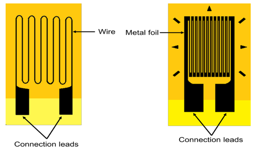

It comprises of a pattern of resistive foil arranged as shown in Figure. These foils are made of Constantan alloy (copper-nickel 55-45% alloy) and are bonded to a backing material plastic (ployimide), epoxy or glass fiber reinforced epoxy.
The strain gauges are secured to the workpiece by using epoxy or Cyanoacrylate cement Eastman 910 SL. As the workpiece undergoes change in its shape due to external loading, the resistance of strain gauge element changes.

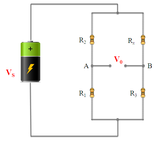

This change in resistance can be detected by a using a Wheatstone’s resistance bridge as shown in below Figure . In the balanced bridge we can have a relation,
R2/ R1 = Rx / R3
where Rx is resistance of strain gauge element, R2 is balancing/adjustable resistor, R1 and R3 are known constant value resistors. The measured deformation or displacement by the stain gauge is calibrated against change in resistance of adjustable resistor R2 which makes the voltage across nodes A and B equal to zero.
