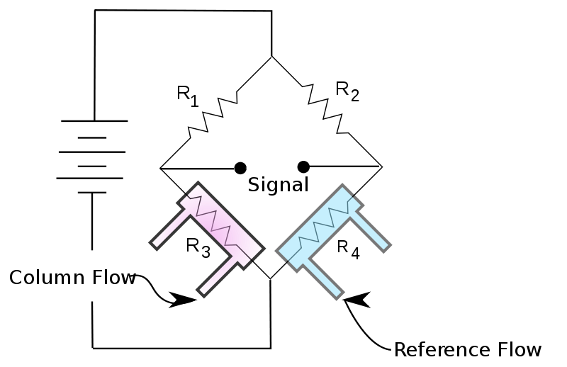

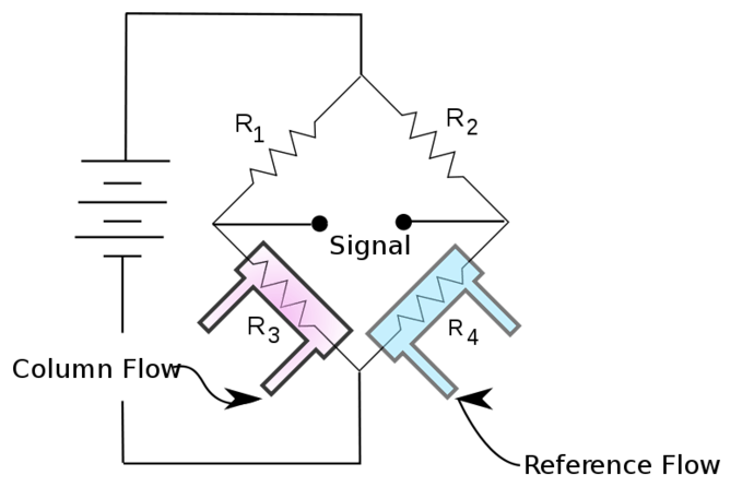

The TCD consists of an electrically heated filament in a temperature-controlled cell. Under normal conditions there is a stable heat flow from the filament to the detector body. When an analyte elutes and the thermal conductivity of the column effluent is reduced, the filament heats up and changes resistance.
This resistance change is often sensed by a Wheatstone bridge circuit which produces a measurable voltage change. The column effluent flows over one of the resistors while the reference flow is over a second resistor in the four-resistor circuit.
A schematic of a classic thermal conductivity detector design utilizing a Wheatstone bridge circuit is shown. The reference flow across resistor 4 of the circuit compensates for drift due to flow or temperature fluctuations. Changes in the thermal conductivity of the column effluent flow across resistor 3 will result in a temperature change of the resistor and therefore a resistance change which can be measured as a signal.
