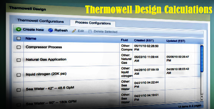

What Does the thermowell design Software Do For Me?
What we have built is a quick and easy mechanism for customers like you to check the validity of their well design against the PTC 19.3-TW with a minimum of effort and pain. The software generates drawings and makes recommendations based upon the options you select. If your well falls outside of the standard software tells you why and what you can do to design a well that will work.

What this Thermowell Design Software do ?
- Provides you with a quick, free wake frequency calculation report based on the new ASME PTC 19.3-TW.
- Allows you to save configurations so that you can come back later to tinker with them.
- Allows you to compare multiple thermowell designs to a single process and vice versa quickly and easily.
- Provides theoretical max insertion and flow criteria on the fly.
- Permits you to print a one page report showing pass / fail results.
- Provides a simple interface to receive pricing for your well with the push of a button.
- And much, much more.
