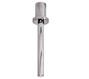

Van Stone Type Thermowell
Such Type of Thermowells are used in High Pressure applications, where the presence of any Weld Joints is highly undesirable.
Due to its sturdy and rugged design, these thermowells are highly suited to resist the effects of High Pressure present in the process medium.
These type are machined from a Single Bar Stock, provided with a Collar of suitable thickness, the OD of which corresponds to the RF OD of the Cover or Companion Flange. These thermowells are sandwiched between a Cover Flange and the Nozzle Flange.
Various types of Instrument Connection and Collar OD can be provided as per the requirement.

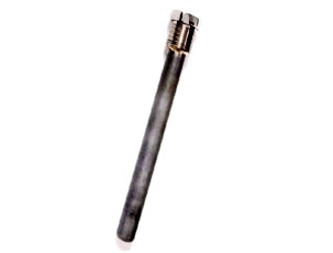

Solid Sintered Tungsten Carbide Type Thermowell
Such Type of Thermowells are used in highly abrasive environments such as Coal Based Power Plants and Air Preheaters etc.
Solid Sintered Tungsten Carbide has got high resistivity to abrasions due to Coal particles, due to which such type of thermowells are highly preferred mostly in Coal Based applications.
Generally the entire Insertion length comprises of Tungsten Carbide. But in cases where insertion length is very long only Bottom Tail Portion is provided with Tungsten Carbide, which would normally come in contact with the abrasive media.

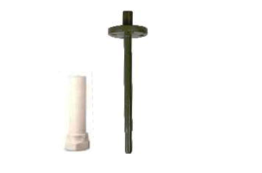

Lined or Coated Type Thermowell
Such type of thermowells are used in chemically active environments. In these type ,a lining or coating, of a suitable Lining material is done, so as to cover the entire Insertion Length .
The Lining material protects the Base material of the thermowell against the corrosive , chemically inert elements present inside the Process medium. Commonly used Lining materials include PTFE, PFA, PVDF. The Thickness of the lining can be provided as per the requirement.
