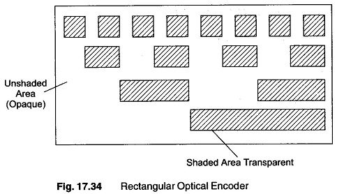

Rectangular Optical Encoder
A sector may be designed as shown in Fig. 17.34, with a pattern of opaque and translucent areas. A photo sensor and a light source is placed on the two sides of the sector. The displacement is applied to the sector and therefore changes the amount of light falling on the photo electric sensor. The pattern of the illuminated sensor then carries the information to the location of the sector.
Figure 17.34 shows a possible pattern on sector of opaque and translucent areas. The number of levels in the encoder determines the accuracy with which the device operates.

To understand the operation of a shaft encoder, let us consider a translational encoder (a linear displacement transducer) shown in Fig. 17.34. The encoder shown has four tracks (bits) and is divided into conducting and insulating positions, with a smallest increment of 0.01 mm. As the scale moves under the brushes, the lamp circuits are made or broken, so that the number shown on the readout lamps is at every instant equal to one hundredth mm.

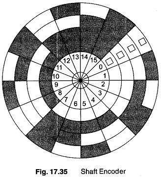

For angular displacements, the pattern given in Fig. 17.34 is changed or modified, so that the length of the scale becomes the circumference of a circle on a flat disc. The brushes are then placed along a radial line on the disc, as shown in Fig. 17.35.
The disc is divided into concentric circular tracks, each of which is then divided into segments in a manner depending upon the code being used.
For pure binary code, the inner most track is halved, the next quartered, the next divided into eight parts, and so on. Each track has twice as many segments as the adjacent one near the centre. The detection method determines the treatment of the disc. Alternate segments on each track are made transparent and opaque, if transmitted light and photo cells are used. If the segments are made reflecting and non-reflecting, reflected lights and photo cells are used. Electrical methods are used for detection in case the segments are made alternately conducting and non-conducting.
The accuracy depends upon on the number of tracks used and if there are n tracks, the accuracy obtained is 360°/2n.
Such discs are manufactured with diameters ranging from 5 — 25 cm and give unique codes for 100 — 50,000 positions per 360°. The sequence and order of indications represent the position of the shaft in the coded form.
