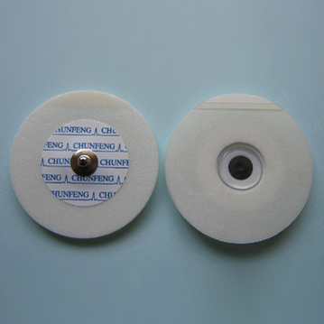

Fig.(b) -
Fig.(b) Concerning with economics disposable electrodes with adhesive material is used.
It is most popular electrode consisting of plastic foam material with silver plated on one side.
The lead wire with female portion is snapped into electrodes & used to connected assembly to monitoring apparatus.

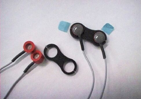

Floating Electrodes:
- Motion artifact cause disturbance in double layered at electrode-electrolyte interface, so floating electrodes offer suitable technique.
- Here metal disk is recessed in cavity so that it does not come in direct contact with skin.
- The gel doesn’t produce disturbance due to presence of double layer charge.

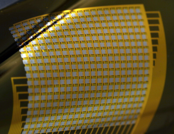

Flexible electrodes:
- They have irregular surface & can change curvature with movements.
- They include woven, stretchable, nylon fabrics with silver particles on one side.
- The carbon particles in silicone makes it electrically conductive.
- Pin is pushed in lead connector hole& used in similar way as metal-plate electrode.
- They can cause skin irritation.
- Flexible lead attached to Mylar by conductive adhesive & silver deposited.
