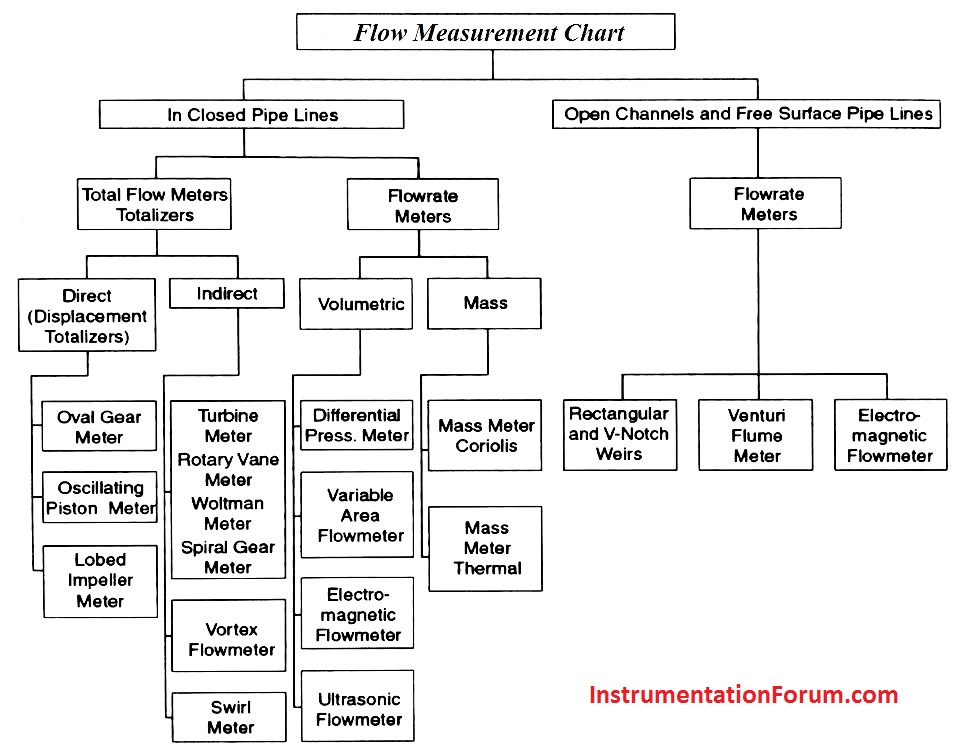

Mention the different Types of Flow Sensors for flow measurement like volumetric flow and mass flow.
Flow sensors are devices used to measure the rate of flow of fluids (liquids or gases) in various applications. There are several types of flow sensors, each with its principles of operation and suitable for different flow measurement scenarios.
Flow Sensors
Here are some common types of flow sensors:
Differential Pressure Flow Sensors: These sensors measure flow by creating a pressure difference across an obstruction in the flow path (e.g., an orifice plate, venturi tube, or flow nozzle). The pressure difference is related to the flow rate and can be used to calculate it.
Turbine Flow Sensors: Turbine flow sensors have a rotating turbine inside the flow path. As the fluid flows, the turbine rotates, and the flow rate is proportional to the turbine’s rotational speed.
Magnetic Flow Sensors (Electromagnetic Flowmeters): These sensors utilize Faraday’s law of electromagnetic induction to measure the flow rate. They work with conductive fluids and measure the induced voltage across the fluid.
Ultrasonic Flow Sensors: Ultrasonic flow sensors use sound waves to measure flow rates. Transit-time ultrasonic flowmeters measure the time it takes for ultrasonic signals to travel with and against the flow, while Doppler flowmeters measure the frequency shift of reflected ultrasonic waves from particles or bubbles in the flow.
Positive Displacement Flow Sensors: Positive displacement flow sensors measure the flow by dividing it into discrete volumes and counting them. Examples include gear meters and piston meters.
Coriolis Flow Sensors: Coriolis flowmeters measure mass flow directly based on the Coriolis effect. The fluid’s inertia causes a tube to twist, and the degree of twisting is proportional to the mass flow rate.
Thermal Mass Flow Sensors: These sensors measure the flow rate by analyzing the cooling effect of the fluid on a heated element or the heat transfer from a heated element to the fluid.
Vortex Flow Sensors: Vortex flow sensors detect the frequency of vortices generated by a bluff body in the flow. The frequency is proportional to the flow rate.
Pitot Tubes: Pitot tubes measure flow velocity by measuring the difference between stagnation pressure and static pressure.
Each type of flow sensor has its advantages and limitations, and the choice of the sensor depends on the specific application requirements, fluid properties, accuracy needed, and the environmental conditions.
