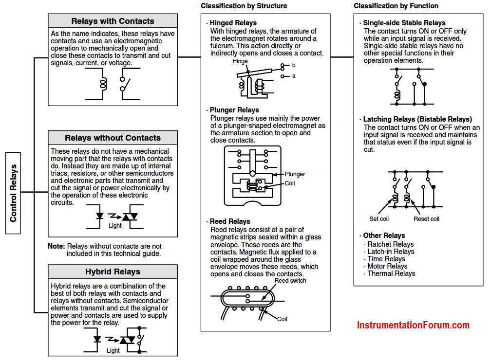

There are different ways to classify relays. The following groupings will be used in this technical guide.
Types of Relays

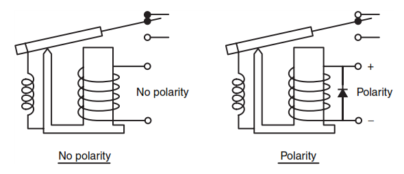

Non-polarized Relays
Non-polarized relays do not use a permanent magnet in their electromagnetic section. This means that generally the operating coils do not have polarity.
There are some non-polarized relays, such as those with built-in operation indicators or surge-absorbing diodes, whose operating coils have polarity.

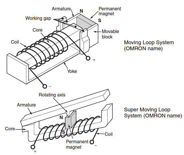

Polarized Relays
Polarized relays use the magnetic flux of the permanent magnet in their electromagnetic sections. This means that the operating coil has polarity.
