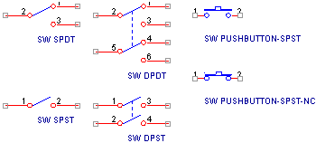

Beside the general type of switch (toggle, slide, pushbutton, etc) there are many configurations of the contacts possible. Often you will see a switch in a schematic referred to as a SPST or DPDT. These stand for Single Pole Single Throw and Double Pole Double Throw.
This is illustrated in the diagram at the right. A switch with a single throw has it’s lines either connected or unconnected. In otherwords there are two terminals with are electrically connected only when the switch is activated.
A switch with a double throw has an extra terminal for each pole so that there are two electrical paths possible instead of just one.
