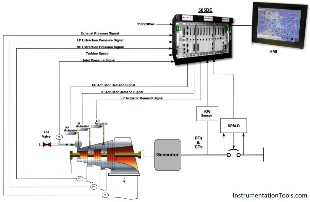

2. Two Valves Turbines: With two valves, the control can modulate two parameters simultaneously. For power plat, turbines in Generator application, this can be a combination of maintaining constant turbine speed and modulating extraction flow. For a variable speed drive such as Compressor application, the two parameters typically are a variable speed control combined with modulating extraction flow. This type of turbine is called a Single Automatic Extraction (SAE) turbine as it has a single extraction port with controlled extraction flow.
1) Single Automatic Extraction:
Turbines with one extraction port are called Single Extraction turbines. The turbine can have control valves on the HP inlet only in which case the extraction flow is not controlled and flow as well as pressure in the extraction header can vary. However if it is important to control the flow in the extraction header, the turbine shall have two valves, one on the HP inlet and a second LP valve downstream of the extraction port. This type of turbine is a Single Automatic Extraction (SAE) turbine. For the majority of SAE turbines, there is only one HP and one LP valve although the design may involve more than one HP and/or more than one LP valves.
Speed / Power Control:
The turbine can drive a compressor in which the turbine speed must vary with compressor demand through a speed governor with the input from a process controller. Another application is a generator operating parallel with a commercial grid. In that case the speed is constant and the control is designed in such a speed/power mode that amount of power from the generator shall not be fluctuating.
Extraction Control:
The second controller is the extraction controller which must modulate the amount of flow in the extraction header. This flow is determined by the demand from the user.
Decoupling:
The back pressure turbine has a control which modulates the flow in the back pressure header while speed or power is not controlled. The SAE turbine is used in applications where both extraction flow and speed or power needs to be controlled simultaneously.
The modern digital control allows de-coupling of the two control modes by making them independent. De-coupling requires the speed/power controller and the extraction controller both operate the HP and LP valves simultaneously.
Rationing:
All steam to provide power must travel from the HP valve, through the HP turbine, through the LP valve and the LP turbine to turbine exhaust with none of the steam travelling to the extraction port. All steam to satisfy extraction demand must travel from the HP valve, through the HP turbine to the extraction port without any of this steam going through the LP section.
Any change in flow demand in the extraction header requires the pressire controller operates both valve simultaneously. The steam does expand in the HP section on its way to the extraction port and that changes the power level. Therefore he LP valve must move in the opposite direction. An increase in extraction demand requires that the HP valve opens but the P valve close to reduce the power produced by the LP valve in an amount equal to the power increase by the HP section of the turbine.
