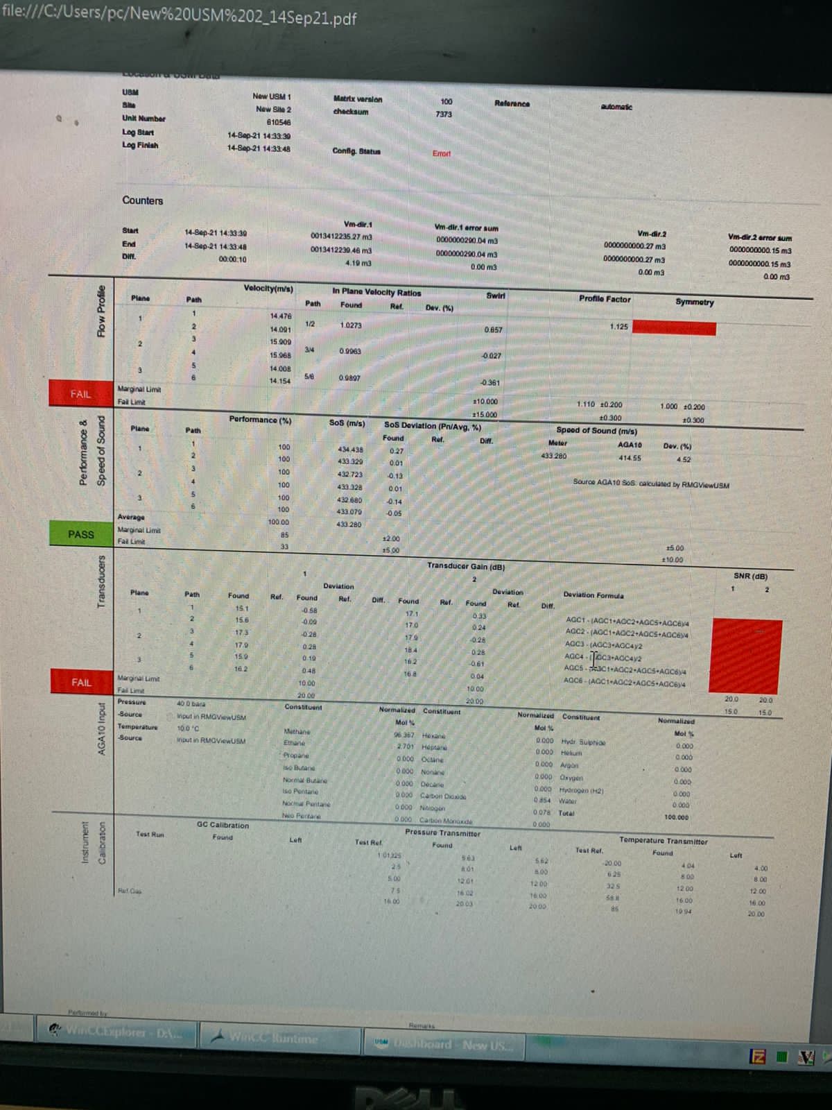

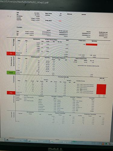

this is an inspection report of ultrasonic gas flow meter in rmgview software
for USZ 08-6p RMG ultrasonic flow meter
what may cause flow profile to fail in symmetry region ??!!
why it fails at transducer report??
how can i fix it??
can you help me please
