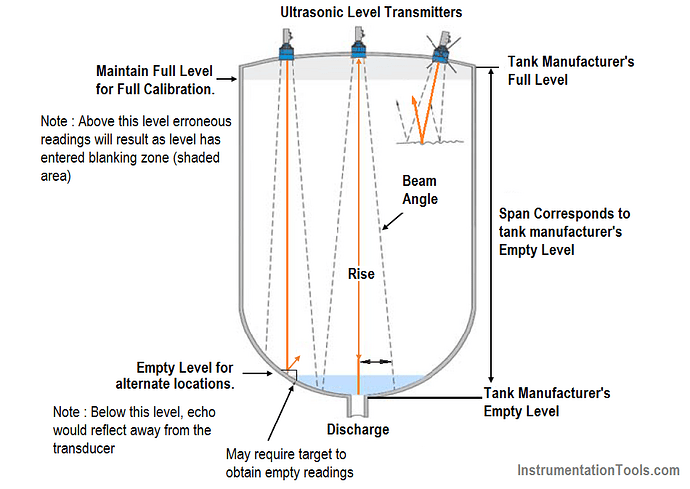

What is a dead zone?
A dead zone refers to the area directly in front of the transducer face where the sensor cannot reliably make measurements. This is due to a phenomenon called ringing. Ringing is the continued vibration of the transducer after the excitation pulse.
The energy must dissipate before the transducer can listen for a return echo. Make sure to locate your target outside of the specified dead zone of your ultrasonic sensor.
